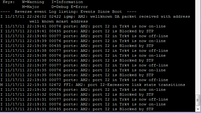

I have 2 trunk ports which are coming from my server to the switch and I am noticing that these trk ports are constantly blocked by spanning tree. The switch log shows the trk1 is on line then off line and as a result I do experience network losses at times.

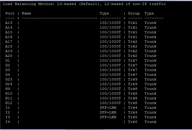

see attached images
User generated image User generated image
Avatar of Don JohnstonDon Johnston🇺🇸
Looks like a trunking problem.
Which physical ports make up trunk 4?
And the ports for trunk 4 go to a server, right?
Physical ports are:
TRK4 = I1 and I2
TRK5 = I3 and I4
These ports are going from the core to a DELL M8024 fabric on the back of a M1000e blade.

What about a "show trunk"?
see image below
I looks like I1 and I2 are members of a static trunk.
If the other end isn't manually aggregating the ports, there's your problem.
That's why I like to use LACP. Much easier to troubleshoot.
I beleive the DELL side is manually aggregating as we had issues initially they would not talk unless they were the same, so we set the M8024 to static.
