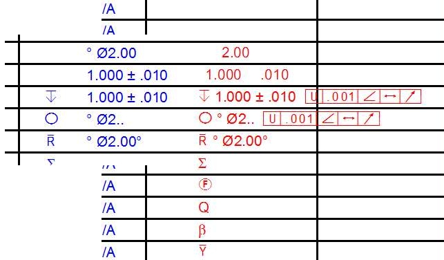

That is getting very close!
One question thought.. and I forgot to mention it not realizing that it would be a problem.. When the arial field is being displayed by itself, any symbols ±, °, Ø are be stripped off but when the arial font appears in cunjuction with either of the other two fields then the symbols are showing up.
See this screenshot.. The font in red is the richtext concatenated version and the blue to the left is the seperate fields lined up next to one another..

My first thought is that is may be related to the Font. Does the Font support those characters?
Arial supports the symbols but when I zoom into the red text (where the rich text concatenation is) it looks for some reason as though its not using arial when the Requirement(Arial) appears by itself..
Let me ask this, In the richText module, what does the Public Enum FontList represent? What is the purpose of it?

I see.. I just wasn't sure if this might be affecting the font symbols and why they are not showing up..
The symbols/characters that can be printed are not control by Access/VBA. Access/VBA can only select the font. It is up to the font to be able to print the symbols/characters
I am trying to figure out how to duplicate what you are doing.
How are you entering the symbols/characters into the text filed? Are you using ALT Codes on the ten-keypad?
Also try setting the font for every field.like this:
=FontType(Nz([Requirement (1GDT)],""),1) & " " & FontType(Nz([Requirement (Arial)],""),2) & " " & FontType(Nz([Requirement (FCGDT2)],""),3)
Yeh, Alt 216, Alt 176 and Alt 0177.
I set the formula back and have the same result.. (I did have it setup that way originally but tried to remove the font portion from the arial font just in case that was causing the issue)

In my example I am only changing the the font. Check out the report named ContactListRT
JeffCoachman, Looks like the symbols are working for you.
I tried to set mine up like yours and now I'm getting #Type! for all of the columns where only one Requirement exist. It works if there is something in every Requirement column.. Here is a print preview of the report;
I changed my formula on the Report to match yours in the example;
=FontType([Requirement (1GDT)],1) & " " & FontType([Requirement (Arial)],2) & " " & FontType([Requirement (FCGDT2)],3)
My Module is setup like this;
Not sure if this would help, but here is the actual data going into the report..
I wish I could see what the problem is... Only thing I think I can tell about yours from mine is that I'm running all the details in one page with some of them having data in all three columns of the report where as some only fill one or two of the columns.. The ones that only fill one or two of the columns in a single line are the ones not producing the symbols.
Ok.. Well it started working when I added the NZ's back into my textbox formula while keeping the If statement in the VBA.. Not sure I understand it but basically adding the If IsEmpty(pTextToFormat) Or Nz(pTextToFormat, "") = "" Then
FontType = "" to my vba the symbols then started showing up..
So to sum up, my textbox formula is:
And my module is:
And now all the symbols are showing up;
Again.. I can't explain why adding that section to the module would cause the symbols to start showing up (on top of having the NZ functions in the textbox formula) I had to have both in order for it to work properly..
Thanks for all your help and committment to this issue!
