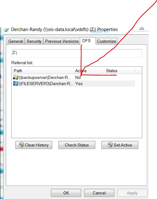

DFS replication issue on mapped drive
I have DFS running on a fileserver with replication on going to a backup server.
I have folder that has multiple folders inside of it. I am currently replicating this main folder only, thereby the folders inside the main folder are being replicated. These folders inside this main folders are personal employee shares that get shared to the employees computer.
Lately, the backup server is mounting as active instead of the primary even though the DFS server tells it not to. I don't know why this happens. Employees put data on this share and then days ย later can't find it becuase the backupserver dfs was mounted without their knowlege or interference. Why do you thinks this is happening and how can i enforce this?
I only want the primary fileserver mounted unless it becomes unavailable. Is the main replicated folder have too many folders within to deal with?

Avatar of arnoldarnold๐Ÿ‡บ๐Ÿ‡ธ
Avatar of vdmsvdms
Well, the problem isn't that it's not backing up, it mounts as the backup and not the primary
when it the backup should never be primary. The picture I sent you says Fileserver3 active and backupserver not active. Sometimes they switch roles and they are not supposed to. FIleserver3 should always be active unless it crashes. Can this be explained?
What is the configuration on the dfs share? Is it in round robin, failover mode where you have the preferred defined as primary.
Avatar of vdmsvdms
The configuration is preferred primary.
I don't have round robin installed on my DNS DC.
