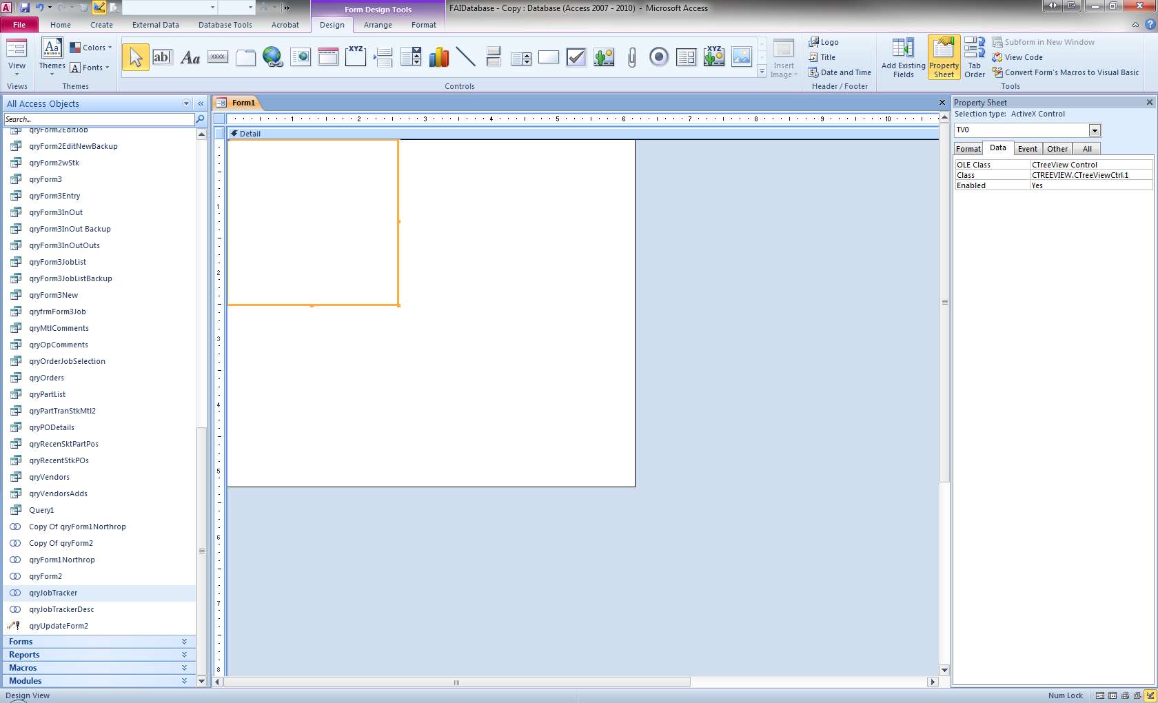

I added an ActiveX control CTreeView Control into my blank form. In design view nothing appears in the ActiveX control where as in the examples It shows some example tree.
Here is how my form looks;

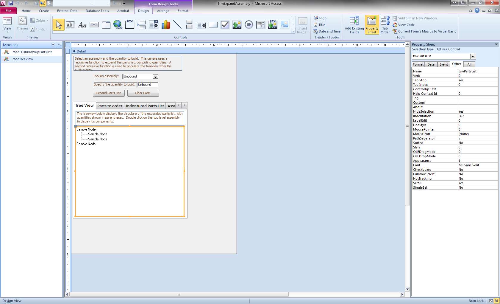

Here is how the example forms look;
