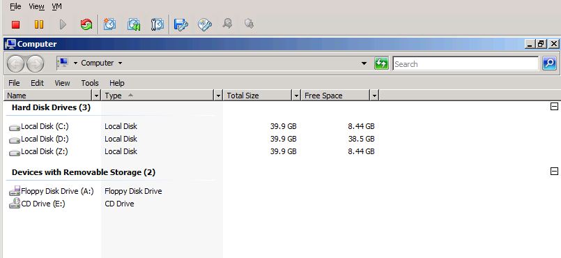

We have cloned Server B from Server A..now Server B is having an additional z drive with 40 GB. Server A is having this z drive. But we have not added this disk on Server B .
i need to remove this additional drive on server B.
Note: i checked hidden disk in device manager and removed. then i rebooted the system. but its showing there.
Attaching screenshot for your reference.

is Z: a substitued drive of C:
e.g does z contain the same files c
check the command
subst
at the command line

z:\: => C:\users\Administrator..what does it mean?
What is subst?
1. Substitution in use, drive letter z: mapped to c: drive. Its a virtual drive mapping, it does not physically exist.
2. Possible left over by P2V process or a manual subst had been invoked.
3. Easy to resolve by using subst delete.
P2V or V2V its the same process.
