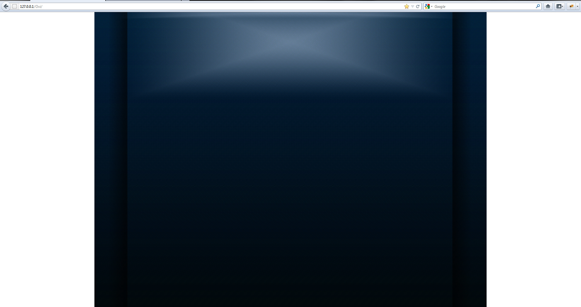

I have the following image here for an example; background
As you can see, I have two side borders and the main content area. It looks like it works here (ignore the white area atm) but I have an issue.
If you size your browser down (aka size the window or have a smaller monitor) the page starts at the sidebar image. I want it to slowly crop out until only the MAIN area is there. Thing is it would need to crop out both sides evenly, I've seen some sites that do it but I'm not sure how.
So in the end there would be no side borders and only the main content area as the minimum width. It shouldn't consider the sidebar images as part of the content, thus making it so the minimum window size is alot larger.
