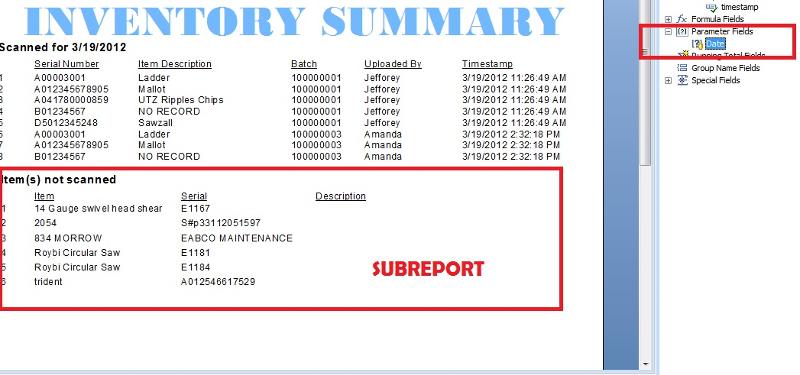

Dear Experts,
I have a report with a date parameter
screenshot 1
it passes it to the subreport
subreport has a query with a parameter
subreport param

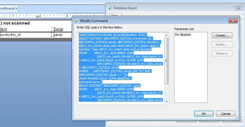

the query is
 select distinct invntryitm_id,serial,itemdesc  from (
SELECT DISTINCT ABCOSPRO_EQTOOL.invntryitm_id, ABCOSPRO_EQTOOL.serial, ABCOSPRO_EQTOOL.itemdesc, ABCO_Inv_batch.date,case when ABCO_Inv_batch.date is null then '' else ABCO_Inv_batch.date end as thedate
FROM         ABCO_Inv_data INNER JOIN
                      ABCO_Inv_batch ON ABCO_Inv_data.batch_rn = ABCO_Inv_batch.batch_rn FULL OUTER JOIN
                      ABCOSPRO_EQTOOL ON ABCO_Inv_data.serial = ABCOSPRO_EQTOOL.serial
WHERE     (ABCOSPRO_EQTOOL.serial LIKE '%') AND (ABCOSPRO_EQTOOL.serial <> ''))x
where thedate not in  ({?Pm-@qdate} )
and serial not in (
SELECT DISTINCT ABCOSPRO_EQTOOL.serial
WHERE     (ABCOSPRO_EQTOOL.serial LIKE '%') AND (ABCOSPRO_EQTOOL.serial <> '') and convert(varchar(50),date) =  ({?Pm-@qdate} ))
for some reason if I enter the date 3/19/2012 the main report takes it but the subreports sees 04/12/3765 or something
??wtf
someone please help
Thanks in advance

Ive tried several things with it. This is why it may seem confusing.
1st I passed just the regular date value straight to the subreport @date
then converted it to a string in the query. this was changed to ?pm-@date
then i tried converting it to text in the formula as @qdate and passing it
a) straight to the query as a parameter.  ?pm-qdate
b) used as a formula to change back to date and pass to query
?pm-qdate..01
the query in the subreport works fine actually as you can see from the screenshot. the values get passed incorrectly between them
it appears that the number gets deranged when it gets passed to the subreport regardless of how i format it
This is its use in the SUBQUERY
subquery

You have to pass the date in the proper format to the parameter fromthe COMMAND.
You are getting the wierd values because the command parameter has a default value.
Edit the command and delete the default value from the parameter.  I had a similar issue and the only way around it was to not have a default value for the parameters.

Ah.  I hadn't noticed that you were using a Command in the subreport, so I didn't realize that you were using the parameter there.  It seems like the report that you posted should have been prompting you for the subreport parameter.  That issue aside, I don't know why simply linking from the main report parameter to the subreport one wouldn't work (or why you would have trouble getting it to work).  If you're converting the date parameter to a string in the report, and converting a date field to a string in the Command, then you need to make sure that both conversions use the exact same format, since you're going to be comparing strings.  But that wouldn't explain the strange dates you were seeing.

ONe thing to try, delete the parameter in the command and add it back in with a more conventional name.
Also, unless the field in the database is a string, there is no reason to convert the date from the main to a string.
