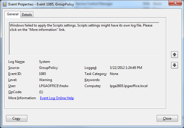

In event viewer, I also see the following error, and this also occurs on the command line when I run gpupdate /force:
Searching on that error yielded the following MS page:
http://technet.microsoft.com/en-us/library/cc727303%28v=ws.10%29.aspx
Which tells me that I can find info about debugging the error on this page:
http://technet.microsoft.com/en-us/library/c08b40aa-2fca-4ab1-aa2a-1589ba7f5420
Which has absolutely no information about how to debug this error.
Looking for any suggestions on where I should go from here.

When I run gpupdate /force, I still get an error about the scripts extension failing, so I assume that there must be some sort of corruption in the default domain policy. However, since other settings in that GPO are still working fine, I am just going to leave it as is with the understanding that we still have an error but that the error is not causing any adverse effects.
Thank you all for your help.
GlobalStrata came the closest by identifying the issue with the scripts processing.
