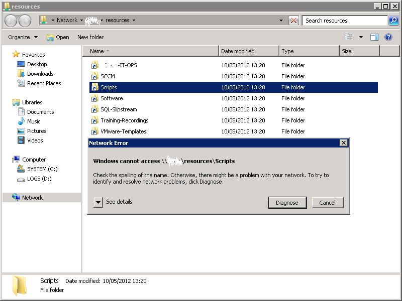

We are currently running AD integrated DFS on Windows Server 2003 Enterprise (x64) SP2. Domain is on native 2003 functional level. I have a problem accessing namespaces from a server. If I type the root of the namespace I can see the links to the shared folders. When I try to open one of the shares, I get an error. See attachment.
The problem is on one server running Windows 2008 and accessing one namespace. Three other namespaces work fine. The namespaces work fine on other servers and clients.
I can access the share directly with \\server\sharename so it is not a question of access rights. There is a new Server 2008 R2 hosting the problematic namespace.

this problem is only on a single (that I know of) windows 2008 server and using the namespace only. I can get the target share open directly from the hosting server. there is no problem accessing via namespace from other servers or workstations. also other namespaces work fine from the problematic server. I was inclined o a referal issue. I'll check the link.
