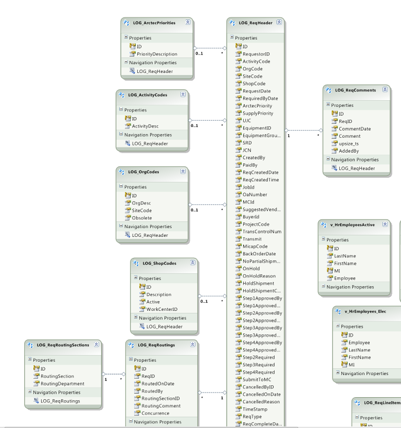

Let's try this...can you attach a .png screen shot of the .edmx data model?
Avatar of AkAlan
AkAlan
Here is a screen shot of the relevant entities.

Ok, I think I see what happened. I was using lazy loading but the Index view that got created by MVCScaffolding created a textbox to display the count of Log_ReqHeaders which then triggered the loading of all the Log_ReqHeaders. I removed the textbox and the page loads very fast now. I need to debug to make sure but it went from a 10 second load to under one second so I think that is what happened. If you have a differing thought, I would like to hear it. Thanks for your time and the link was very useful in helping me learn how this works. Now on to the next problem.
