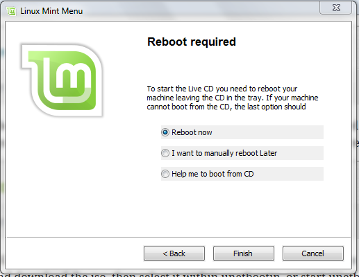

Opened drive E
Opened Mint4Win.exe
See SC1
Dialog box opened and clicked on "Demo & full installation"
See SC2
Then SC3 opened and I chose "reboot now"
see SC3
When the reboot finished there was nothing new on the
desktop and I was back where I started.
On other trys I got  other results
see SC4, SC5, & SC6
I also tried booting from "boot" on SC1 but nothing happened.
Avatar of rindi
rindi
Flag of Switzerland image
You have to boot from the stick, not open it from within Windows. After it has been written to the Stick shut down the PC. Then turn it back and, since it is a Dell, press F12, that should bring up a boot selection where you can select that you want to boot from USB and not the Harddisk. After that the PC will boot to Linux Mint and not windows....

I opened mint4win.exe
see SC7
Then the "no disk in drive" notice came up. (even though a CD was in the drive)
See SC4
Next, I clicked on continue and followed the reboot instructions
See SC3
I booted from the disk and my desktop re-appeared as usual with no change.
End of story
Avatar of Darr247
Darr247
I hope you find a soft wall, rindi.
Avatar of rindi
rindi
If you are opening "mint4win.exe", you aren't booting that mint USB stick you made, but you are starting a windows program from within windows. I asked you to boot directly from that USB stick, not to start any program from within windows on it. Mint4Win.exe is a windows program, not a Linux program. Linux programs don't end with "exe".
