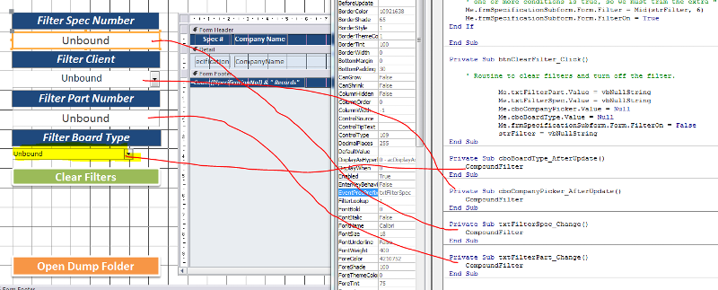

User generated imageA few months ago I posted this question about compound filtering a form with text boxes and a combo box, with the filtered data updating after every keystroke into a text box:
https://www.experts-exchange.com/questions/27590713/Compound-Filter-a-Subform-2-Text-Box-1-Combo.html
I received the perfect answer to my question by pteranodon72
I am now coming back to make an update to this form, I want to add a combo box to the existing filter, but I cannot get the code to work.
The code below works only on the original two text boxes and combo box. I have introduced a new combo box, and edited the code to what I *think* should work, but when I choose a value in the newly added second combo box, I get an 'Enter Paramater Value' box appear.
How can I introduce the second combo box to the filter so it just further compounds my filter?

And the image attached shows my new combo box (yellow).
Avatar of mbizupmbizup🇰🇿
That EnterParameter box appears when a field in your criteria is unrecognized as part of your query.
You should look at the recordsource query for the form that you are filtering and ensure that BoardType (your newly added field in the filter) is indeed part of that query's SELECT clause.  If not, you need to adjust the query or correct the field name "BoardType" as needed.
In other words, check typing,  missing spaces such as [Board Type], actual presence of this field in the recordsource of your subform, etc... any of these will cause the parameter prompt to appear.

Avatar of Computer_Support_NorwichComputer_Support_Norwich🇬🇧
Thank you very much indeed.... it was the
strFilter = strFilter & " AND BoardType=" & chr(34) & Me.cboBoardType.Value & chr(34)
Which i was missing.
Glad that helped :-)
Improperly delimited fields can result in a couple of issues -
- If you mistakenly use quotes or other delimiters on a numeric field, you'll get a type mismatch error.
- If you omit the quotes on a text field (as was the case here), the literal text that you are trying to use for criteria will be mis-interpreted as a field name rather than literal text.
