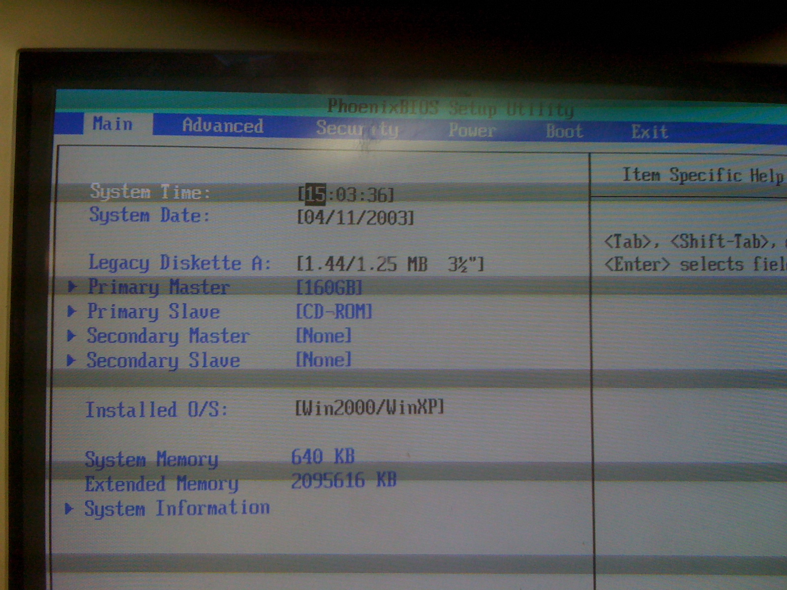

IDE Peripheral Setup

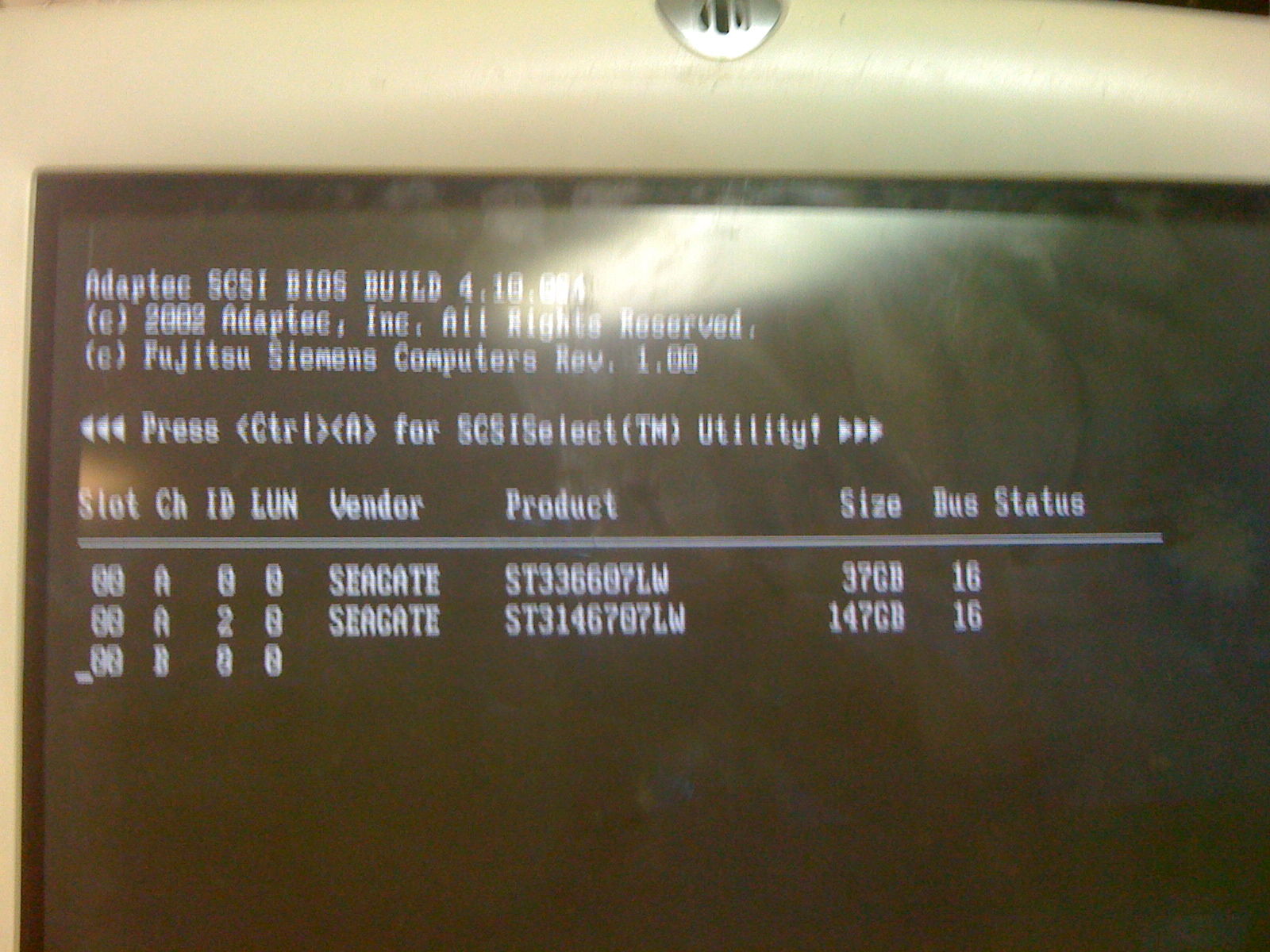

At this point I should be seeing my harddrives (Both SCSI and IDE) but no luck. So I started on a journey to download the appropriate AIC7902 ADAPTEC storage drivers and Western Digtal storage drivers. I downloaded what I believe to be the correct drivers on a USB device, so when the  Select Driver to be installed , I simply should be able to browse the USB like so:

thanks for the response, but my images clearly show that the IDE drives appear in the bios. I am not interested in a raid scenario , as it is not germane to my issue , which is to find the appropriate storage drivers for the scsi drives and ide drive. Also, I thought my images would spark some conversation about what specific make and model this server is and what type of motherboard it actually is. I will do a more indept query looking for the exact make and model. Please continue to respond if you think of anything else.

Right, here is the motherboard http://www.sdsspares.com/parts-spares-detail.asp?prodID=S26361-D1357-A102  Not Intel but looks like a Tyan.
James Murphy
dbrunton
dbrunton
http://www.xpheads.com/forums/146229-post6.html talks about your board and gives links to Tyan page.
Tyan manual ftp://ftp.tyan.com/manuals/m_s2676_100.pdf
Various drivers here http://www.tyan.com/support_download_drivers.aspx?model=S.S2676
The Vista drivers may work.

Davis McCarn
The manual for the system board says that the maximum capacity for the IDE/SATA drives is 160GB (page 34) and you don't want to boot to the SCSI.  Use it for additional storage.
Get an 80 or 120GB IDE/SATA drive and I'll bet things work much better.
