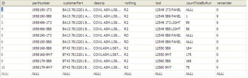

I am using a datareader to loop through 10 records in a table. As it loops I want to update a column but adding two columns.
Basically, I want to add 'countTotalByRun' and 'remainder' and update 'countTotalByRun' to that sum.
MyTable
I am trying to do this, but it's failing on the cmd.ExecuteNonQuery saying a datareader is already open and needs to be closed first:

if you don't need to actually "read" the data, but just "update" it in the backend, you should implement a plain update query right away?!
UPDATE partnumbers
  SET countTotalByRun = remainder+ countTotalByRun
that way, no need to bring back data from the server to the client, and no need to do a "row by row" processing.
1 update command, all the work done, minimal time.
 ssql = "UPDATE partnumbers
  SET countTotalByRun = remainder+ countTotalByRun "
objCommand = New SqlClient.SqlCommand(ssql, objConnection)
  objCommand.ExecuteNonQuery
note: if really you need to "read in" the data, and then execute a statement on the same connection, you need to either:
* open a second connection (to the same db) to run the update statements (but you might run into locking issues as you select and update the same table at the same time)
* better: read in all the data using a datatable, and build/run the update sql using the datatable as input.
LVL 1
Author Comment
by:G Scott
angelIII, that makes total sense, however, with the remainder + countTotalbyRun it takes the 1 and the 9 and makes it 91 instead of 10.  Any thoughts?
LVL 1
Author Comment
by:G Scott
Disregard.  ID10T error on my part. Columns were set as string values.
