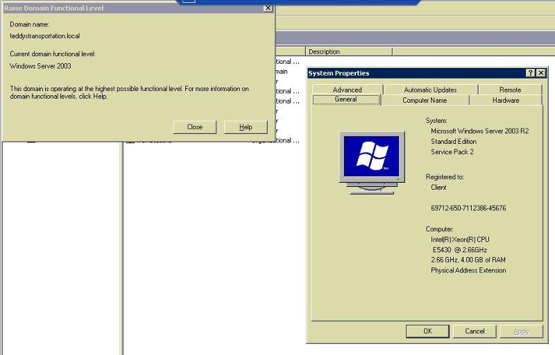

I have just installed a new server 2008 r2 sp1 in an existing domian. The old DC is Server 2003 r2 sp2.
I raised the domain functional level to 2003 from 2000 mixed.
I preped the existing domain by running (adprep /domainprep /forestprep  /gpprep) on old server.
