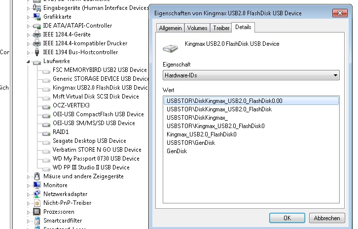

Have a look into the picture to see, how you can find such devices in the registry. You can also seach for the name of the device or a part of it.
But rather than deleting such values in the registry, you should uninstall them all, and then try to seach the registry, if there is something, what is left over. Nevertheless there are some default registry keys for some special devices, so don't delete something, what you are not absolutely sure, what it is. YOu will even find some devices, which never where connected to your computer as MS puts some special devices into the registry to make them work without additional impact.

In the picture (the one I forogot to attach) you find them as well somewhere.
The picture gives you an idea, for what to search in registry and if there is something left over. But as I said, there are some default components installed by the OS. But you may identify your device.
