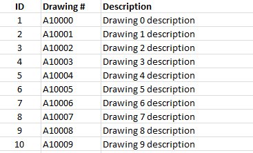

The data is stored in a table that looks something like this:

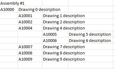

I'm trying to produce a report that looks something like this:

I don't see a parent/child relationship in your table that would define which nodes belong where in the tree. Â From the data you provided, I would have put them all on the same level. Â To do this properly, you need another field (I usually call it ParentID) and the data would look something like:

If you want to do this in a report, the only way I know to do so would be to create a report based on the first level of your data (ParentID IS NULL). Â Then create a subreport where the Criteria is (ParentID IS NOT NULL). Â Embed that subreport in the Detail section of the main report and create a Master/Child relationship between the ID value in the main report and the ParentID in the child. Â This would get you the 2nd level. Â
Then, you would need to embed that subreport in the Detail section of the subreport again to get the next level of the "tree".
