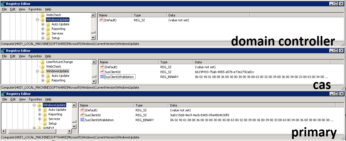

Thanks for the suggestion. Actually the 3 machines were cloned and sysprepped. Anyway I checked, and:
- The DC doesn't have any reg key under HKLM\SOFTWARE\Microsoft\Windows\CurrentVersion\WindowsUpdate
- Both the CAS and Primary have 2 keys there: SusClientId and SusClientIdValidation - both different on both machines...but no PingId nor AccountDomainSid as specified in your link. I guess the DC not having any key at all is not normal...
To clarify my OP, all 3 machines are showing up in WSUS on the Primary, under "Unassigned computers" with the "Not yet reported" status.

@dstewartjr
Yes I did check the reg keys mentioned in the document and run a crazy amount of run wuauclt /resetauthorization /detectnow already :)
As said, the DC didn't have any of the 3 mentioned keys (PingID, AccountDomainSid, SusClientId) while the CAS and the Primary only had the SusClientId, and another one called SusClientIdValidation. (please see attached).
Both keys are different on both computers. I still ran the .BAT to re-randomize SusClientId key and run a wuaucult /resetauthorization /detectnow for the sake of it, but obviously it didn't help.
