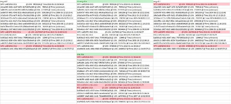

I did some googling on the "Replication access was denied" message and it sent me down the path to verify if my USN numbers matched up to see if I had a USN rollback. I've attached a screen capture of my 4 domain controllers and how they matched up with each other. I compared them all against the DC in the middle, and highlighted in red the discrepancies.
USN discrepancies between DCs
I'm at a loss for what to do at this point, the summary showed no errors, but clearly there's a discrepancy between the domain controllers on the USN numbers.
We have about 10 users added and close to that number disabled or removed every day, I have backups for each DC, but I don't know which ones I should restore or if I should restore at all. The other option that was stated if I had a rollback occur was to demote then re-promote all my DCs.

What events are you seeing in your log?  Did you see this article
http://support.microsoft.com/kb/2022387
Are these DCs in the same site or different site?  The largest delta denotes the longest replication gap amongst all replication links for a particular domain controller.   If they are in different sites that is not horrible and no fails is a good thing

Hi Mike,
They are indeed in different sites, I just didn't know if the size of the delta was something to be concerned with. I'll look through the link you provided to do some more testing.

Using your link, I started down the path of checking with dcdiag, I got some errors pointing to the same problem, so I searched for that string in google. The result that I got on the first try said "run your command prompt with elevated privileges and try again"
I did and didn't get a single error.
This is me smacking my forehead, how many times has not running the cmd prompt in elevated mode bit me.
Thanks for getting me on the right track.
