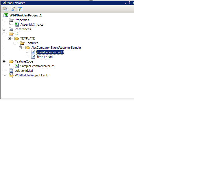

Thanks all. I've created one project
http://dl.dropbox.com/u/40211031/WSPBuilderProject1.zip
per what I've mentioned originally.
But I am getting these when building it.
Error    1    The type or namespace name 'SharePoint' does not exist in the namespace 'Microsoft' (are you missing an assembly reference?)    c:\proj\WSPBuilderProject1\WSPBuilderProject1\FeatureCode\SampleEventReceiver.cs    4    17    WSPBuilderProject1
Error    2    The type or namespace name 'SPListEventReceiver' could not be found (are you missing a using directive or an assembly reference?)    c:\proj\WSPBuilderProject1\WSPBuilderProject1\FeatureCode\SampleEventReceiver.cs    8    40    WSPBuilderProject1
Error    3    The type or namespace name 'SPListEventProperties' could not be found (are you missing a using directive or an assembly reference?)    c:\proj\WSPBuilderProject1\WSPBuilderProject1\FeatureCode\SampleEventReceiver.cs    10    41    WSPBuilderProject1
How to resolve it?

I'm surprised you are doing this with event receiver code. As I said, doing this as a workflow in SharePoint Designer is much easier than writing event code and you wouldn't have to deal with errors like this. But to each his own and maybe event code is easier for you.
What are your references in solution explorer and what are your using statements at the top of your file? Also, if I remember correctly, you have to add an entry of your namespace to the GAC, but i think Visual Studio should automatically do that for you.

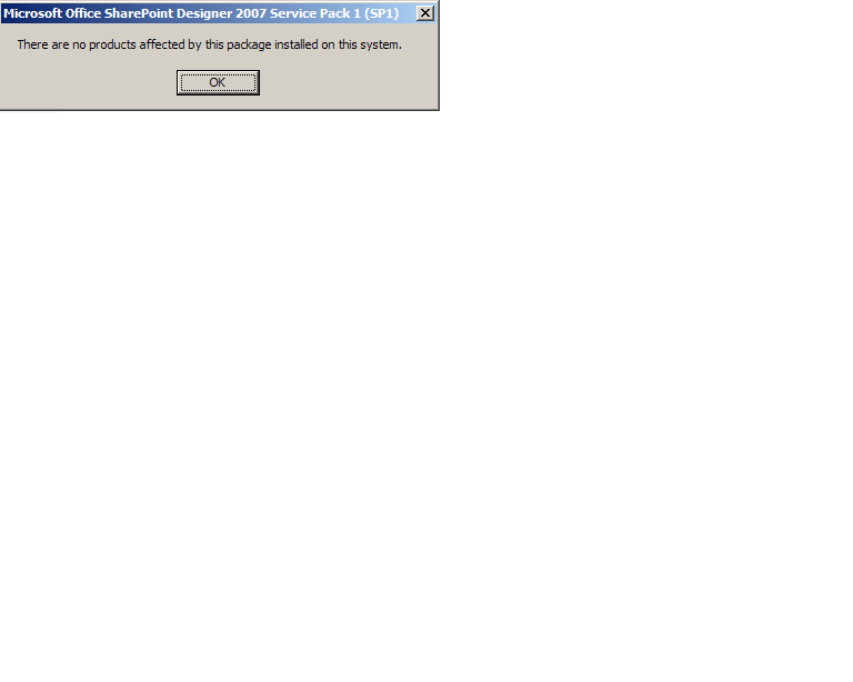

Furthermore, by this setup, why can't I have sp designer after the installation? If I try to run this for setting up sp designer within the server
en_office_sharepoint_designer_2007_service_pack_1_x86.exe
I've got the attached screenshot. Why?

It looks like you tried you install the service pack before you installed SharePoint Designer. It's telling you there is no version of SharePoint Designer installed on your machine for the service pack to act on, so somehow you downloaded the wrong thing.

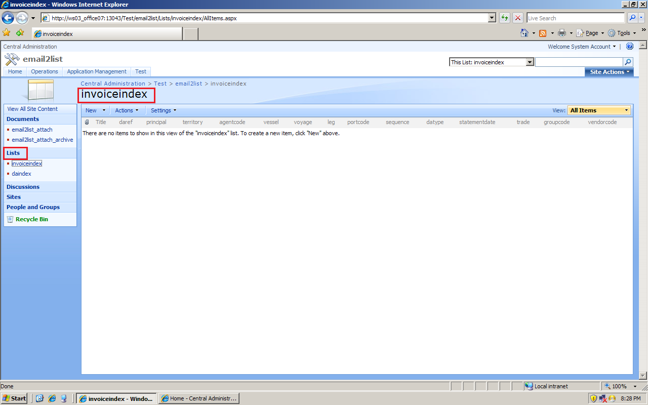

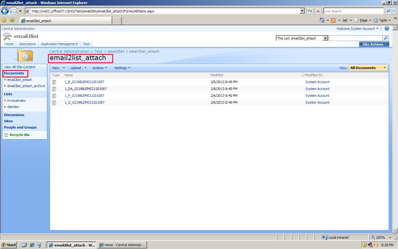

In Fig 1, there are files inside "email2list_attach" which is one Document library.
In fig 2, within "invoiceindex" that is a List, you see I have defined different fields/columns.
What I need is to capture one file within Document library and then append the contents of it, line by line, to the columns of a List.
For this from you
This meant that after you open the site, look at the nav on the left, and navigate to the list where you want the workflow created for.
can you please show also by a screenshot, which list I should navigate to?

Flag of Hong Kong image
The data transfer for input file in Document library to the List, happens only when one input file has been uploaded. So any newly uploaded file will be transferred to the List, if such way is possible to achieve. Many thanks.
Avatar of Arnold Layne
Arnold Layne
So when someone uploads a doc to a library, do you want it to be copied and added to a different document library automatically as well?
Avatar of Peter Chan
Peter Chan
That is not a problem, and please leave it. We only care the data transfer would happen when one input file has been uploaded into one specific Document library, like the example shown above few hours ago.

Hi Bob,
Please see the attached figure again, inside which I've defined the List inside Sharepoint central admin.
you see I have defined different fields/columns in it.

Please see the attached one,
inside the project, I have the feature.xml file. Do you have the tutorial/sample to handle with feature.xml and elements.xml files inside the project?

You have only one feature, so you really don't even need to create a wsp. So on your file system drive, go to 14\Templates\Features  or 12 if you have 2007.
1) Create a new folder inside of Features, preferably the same name as your project has so you know which project to open to edit that feature later on. This will be your feature name, so name the project and folder you add within the Features folder with something meaningful.
2) Review your feature.xml and make sure it points to your elements.xml file (or whatever you named your elements file), as being in the same folder, so you don't even have to add a path to it if it's going to end up in the same folder, which it will.
3) Make sure your elements file points to your event code file as being in the same folder as well because this is where you are going to put it.
4) Then in Features.xml, make sure you have a list name specified, so that this feature will be deployed to any list that has that name across the site collection.
5) Then, from your file system (not Visual Studio), copy Features.xml, your element file and your event code file into the new folder you created inside the Features folder.

Appreciated a lot to your continuous help. what details should be inside element.xml file? Can I have the details of the way to create that?
Any problem with my current eventreceiver.xml file, that is
<?xml version="1.0" encoding="utf-8" ?>
<Elements xmlns="http://schemas.microsoft.com/sharepoint/">
      <Receivers ListTemplateId="104">
            <Receiver>
                  <Name>SampleEventReceiver</Name>
                  <Type>FieldAdded</Type>
                  <SequenceNumber>10000</SequenceNumber>
                  <Assembly>ListEventReceiverSample, Version=1.0.0.0, Culture=neutral, PublicKeyToken=b76b58963356367a</Assembly>
                  <Class>ListEventReceiverSample.FeatureCode.SampleEventReceiver</Class>
                  <Data></Data>
            </Receiver>
      </Receivers>
</Elements>
Any problem with my current feature.xml file that is
<Feature xmlns="http://schemas.microsoft.com/sharepoint/"
 Id="{4F2F7A38-F708-41BB-A2FF-53FC57CB5BF5}"
 Title="Sample List Event Receiver"
 Description="This is a sample."
 Scope="Web">
      <ElementManifests>
            <ElementManifest Location="eventreceiver.xml"/>
      </ElementManifests>
</Feature>
If yes, how to adjust both?

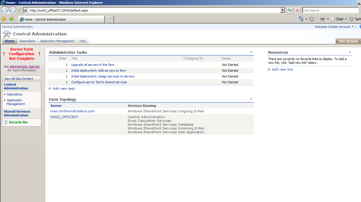

Are you the server administrator? If you are not, you need to ask the server admin where the regular SharePoint site is. If you are the server admin, you have completely fouled the SharePoint installation up. I have no idea how that can happen, but somehow you managed to do that.
So before you do anything, take the time to read the basics of SharePoint instead of thinking every thing is so easy and you can just push your way through this. Then, after you have a reasonable understanding of it, uninstall SharePoint and reinstall it correctly.
This is why I kept asking about this issue over and over again, and you wouldn't answer me until now. I suspected something was wrong with the entire set up and if you are both the server admin and the site admin, then it is definitely the wrong set up because you don't even know that there are supposed to be two sites, one where all your info is stored and viewed, like the list that holds you text files, and then another site with a port number attached to the end of it's address, which is your central admin site, and that is used to administrate your regular site.
You don't put lists on your central admin site, you put them on your regular site. So I'm sorry, but you are completely lost, and you wouldn't be if you had just taken a little time to learn about SharePoint rather than thinking you can just dive right in. So your assumption is now costing you.
Peter Chan
Please see the attached file. I think it is the admin site.
Arnold Layne
Your entire set up is a complete mess and you probably shouldn't be messing around with SharePoint. That is your Central Administration site, and that is NOT where you deploy solutions to, you deploy them to the regular site, but you don't even understand that there is supposed to be a regular site, and therefore you've never even seen it and have no idea where it is, so you have zero basic knowledge of SharePoint and yet you are trying to deploy event code and solutions, which are the more complex things that one does in SharePoint.
On the page you attached, go to the left nav and select configuration wizards, and select "launch the farm configuration wizard".
