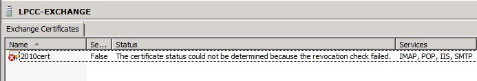

The certificate status could not be determined because the revocation check failed.
Went through the whole process with godaddy on the phone.  Everything went smoothly until the last step where the cert was supposed to become active.  Then we got the error as listed in the title of this question.
Any help would be greatly appreciated as godaddy was unable to help past this point.

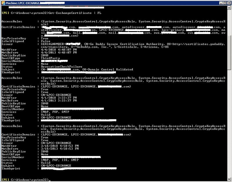

Get-ExchangeCertificate | FL
- Rancy
thank you Rancy,
so, run the cmdlet and let us know the output
Regards,
Exchange_Geek
see screenshot
As seen the 3rd one is the one with all services assigned to it .... did someone after the second add IIS and Enable again ?
- Rancy

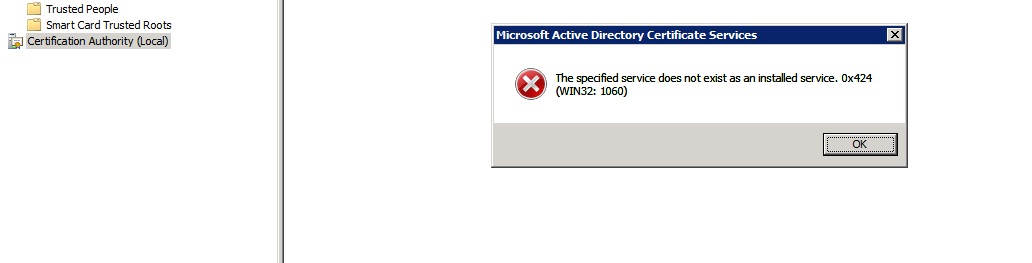

I get this error when trying to load the snapin for certificate authority on my domain controller..
could this be related to the problem?
Check if services are running and Remote registry and CA server is contactable
- Rancy
The DC wasnt a CA server is what I found.  I just installed the services on it and I guess will retry this cert again..  Do I have to generate a new request and go through all those steps or can i somehow just make this one that failed work?

Get-ExchangeCertificate results in
Services: IP.WS.    Subject:  CN=domain.com, OU=Domain Control Validated

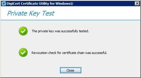

After reboot it still shows the error..  What I dont understand is this:
I downloaded the digicert utility and ran a revocation test, and it passed.  It only fails from the management console..
Why?
