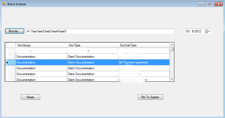

Below, is a screenshot of the form to get an idea.
So what I need to happen is this:
1. The user will browse for a “folder”.
Within the selected folder will be a few 100 files all having different file names. The file names will all have an account number in them. So an example of what the files will look like are below:
63255 – People HWU Oct 2012 – Final Steve Markesu.pdf
4872345 – People WOOPW Oct 2012 – Final Maria Menez.pdf
October 2012 Harry Towner Acct09839.pdf
Peters Plumbing Acc4940523 Oct 2012.docx
2. The user will then select a filing date.
3. The user will then select an area from the datagrid box. This datagrid box is linked to a sql database table.
4. The user will then push the “File To System” button (button3).
When that button is pushed the program will output what the user selected to the “C:\Indexbatch<date and time stamp of when this file is created>.sdd1” file.
Contents of the output file must be similar to the below examples:
H:\test\test2\test3\test4\test5\63255 – People HWU Oct 2012 – Final Steve Markesu.pdf|63255|63255||Documentation|Client Documentation|Bill Payment Agreement||10/09/2012|
H:\test\test2\test3\test4\test5\4872345 – People WOOPW Oct 2012 – Final Maria Menez.pdf|4872345|4872345||Documentation|Client Documentation|Bill Payment Agreement||10/09/2012|
H:\test\test2\test3\test4\test5\October 2012 Harry Towner Acct09839.pdf|09839|09839||Documentation|Client Documentation|Bill Payment Agreement||10/09/2012|
H:\test\test2\test3\test4\test5\ Peters Plumbing Acc4940523 Oct 2012.docx|4940523|4940523||Documentation|Client Documentation|Bill Payment Agreement||10/09/2012|
So the first part of the output is the folder location that the user selected as well as the file name of the file within that directory.
Next is the account number that was read from the file name. The account number is between 5 and 10 numbers. So the program must look for a 5 to 10 digit number (no spaces or dots etc) from within the file name and place it in the output file twice and separated by the | as seen below.
|63255|63255||
Next is what was selected in the grid from the DocGroup, DocType and DocSubType columns
Lastly is the date that the user selected being MM/DD/YYYY
||10/09/2012|

Avatar of Bob LearnedBob Learned🇺🇸
So much information that I am not sure what you are asking for...

Essentially all i want to do is export all of the values the user selected on the design form in to a text file.
The above codes outputs the below line to the text file:
H:\test\test1\test2\test3\|4/25/2013
I now need to know how to get this code to output:
1.  The file names from within the directory the user chose from the textbox.
2. The code to read the account number from within the filename and place it in the string of output.
3. The code to read what the user selected from the datagridview box and place it in the string of output.
4. The date to be formatted as MM/DD/YYYY in the strings output instead of M/D/YYYY
So final result would look like this:
Does this information help out any?

I managed to use some of your code regarding the DataGridView to get sucessful results with the below code.
Private Sub Button3_Click(sender As Object, e As EventArgs) Handles Button3.Click
        Dim objWriter As New System.IO.StreamWriter("C:\output\output.txt", False)
        objWriter.WriteLine(TextBox1.Text & "||" & DataGridView1.SelectedRows(0).Cells(0).Value & "|" & DataGridView1.SelectedRows(0).Cells(1).Value & "|" & DataGridView1.SelectedRows(0).Cells(2).Value & "||" & DateTimePicker1.Text & "|")
        objWriter.Close()
    End Sub
End Class
Which works beautifully. Results when run below:
C:\Marketing\Clients||Documentation|Client Documentation|Address Change||04/09/2013|
So you have solved my problem of getting the selected values from the datagridview.
Can you help me now with getting the file names within the directory chosen from button1
(code below), in that output line as well. Which i think you tried already from your code above but its not working, you did say it was untested.
Private Sub Button1_Click(sender As Object, e As EventArgs) Handles Button1.Click
        If FolderBrowserDialog1.ShowDialog() = Windows.Forms.DialogResult.OK Then
            TextBox1.Text = FolderBrowserDialog1.SelectedPath
        End If
    End Sub
N
Avatar of Nasir RazzaqNasir Razzaq🇬🇧
txtDirectory is the name of the textbox where user puts the directory so you have to replace it with the name that you are using. Similarly, txtDate is the date selection drop down.
Avatar of KevinKevin🇺🇸
Thank you very much Code Cruiser.
