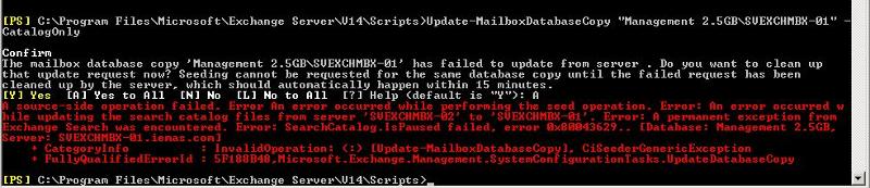

Hey Guys,
Hope you can help with this one.
I am running Exchange 2010 with a DAG setup between 2 mailbox servers. The database on the passive server MBX02 had a state of "Failed and Suspended" after recreating the dag it went into a healthy state. And after a couple of hours the database automatically failed over to MBX02 making it the passive node and showed that the database which used to be Healthy on MBX01 was now in a Failed and Suspended state.
So I investigated a bit and cannot seem to get it in a healthy state again.
I tried a couple of EMS scripts in the hope of resolving the issue and these were the results:
Update-MailboxDatabaseCopy "Management 2.5GB\MBX01" -CatalogOnly

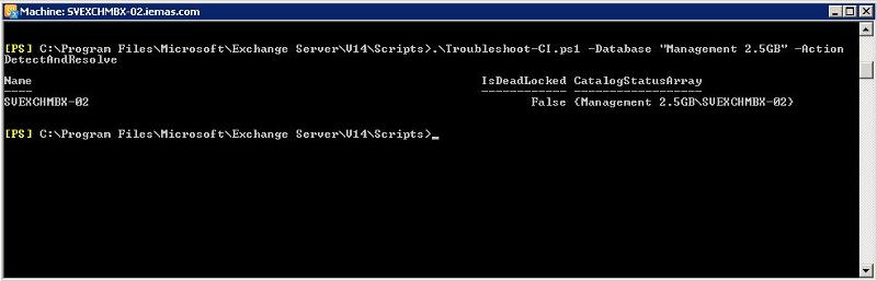

Troubleshoot-CI.ps1 -Database "Management 2.5GB" -ActionDetectAndResolve

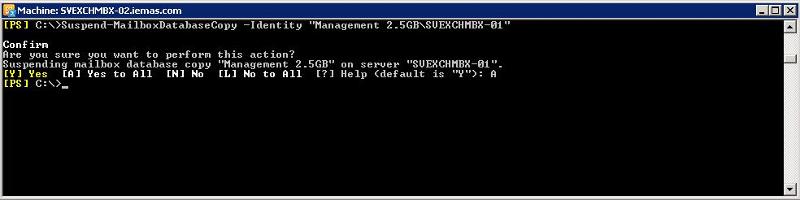

Tried to force the database to suspend (Suspend-MailboxDatabaseCopy -Identity "Management 2.5GB\MBX01") and then resubmitted the Update-MailboxDatabaseCopy as mentioned above with the same result
And I also ran the following and am very concerned that both databases (Active and Passive) has a failed ContentIndex State
Get-MailboxDatabaseCopyStatus -Identity "Management 2.5GB"
Does anyone know how I can get the active copy in a Healthy ContentIndex State without moving every mailbox to a new database or doing a restore from backup?
As always your help would be greatly appreciated.
Thanks in advance :)

Tried it an it fails with the following:
LVL 15
