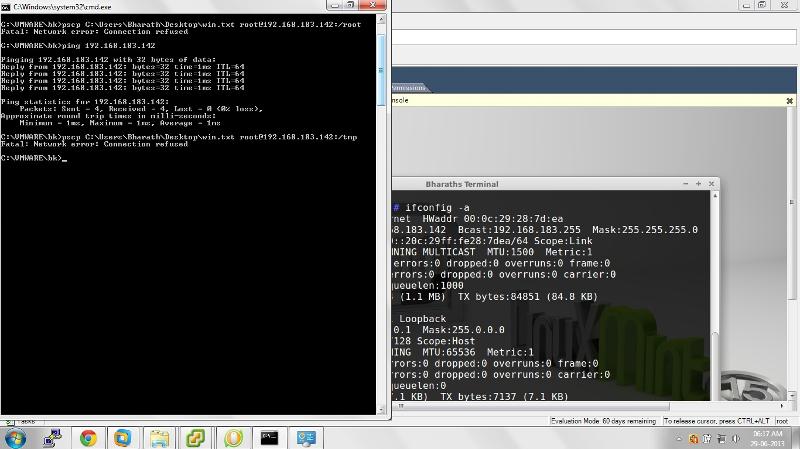

Fatal Error in connecting A linux VM in putty
HI ,
Iam getting an error while connecting LINUX VM which is installed in vmware ESXi server via putty...and also it is pinging from my host machine(win7) as well...
C:\VMWARE\bk>ping 192.168.183.142
Pinging 192.168.183.142 with 32 bytes of data:
Reply from 192.168.183.142: bytes=32 time=1ms TTL=64
Ping statistics for 192.168.183.142:
    Packets: Sent = 4, Received = 4, Lost = 0 (0% loss),
Approximate round trip times in milli-seconds:
    Minimum = 1ms, Maximum = 1ms, Average = 1ms

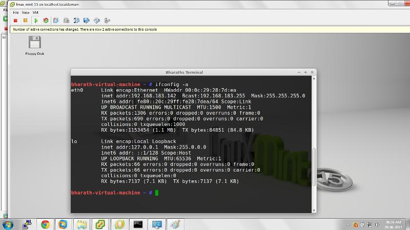

AND if config of Linux mint is attached please find it and help me please it is very confusing me..............LInux_mint_15 ifconfigping works fine of linux VMBut putty showing fatal error

BharathKumarRaju DasaraRajuDevops EngineerAuthor Commented:
firewall is inactive i don't find SSH installed....actually previously i was installed so many.......LINUX vm's but able to connect after installing........please see the attachment....i think firewall ssh not a problemSSH_status_firewall_status
Vijay Pratap SinghCommented:
Install SSH and disable SELinux and try again xD
@rickyzen thank you i installed openssh-server and now iam able to login using putty via ssh protocol.....and i have another question now.....
