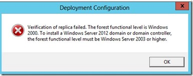

Problem Raising domain funtion level to 2003 after raising forest funtion level to 2003
I have a domain controller that is running Windows Server 2008r2. Last week we had a storm and now the dhcp server service is no longer working and will not start. I am trying to setup a new DC running windows server 2012. I have read that the domain and forest functional levels should be raised to at least Windows Sever 3003 functional level. I read that when I raise the forest functional level to 2003 that the domain functional level will be raised automatically. When I look in AD Domains and trusts, I see that the current forest level is now 2003 but the raise domain funtional level still shows the current domain funtional level is "Windows 2000 native". If I try to raise it to 2003 I get the following message: The funtional level could not be raised. The error is: The FSMO role ownership could not be verified because its directory partition has not replicated successfully with at least one replication partner.
I need to make this server a domain controller to take over the roles of the problem DC.
Any advice on how to proceed to make this a domain controller with a domain funtional level of 2003? Is there anything special that I need to do to promote the 2012 server to a DC??
Any thoughts would be appreaciated.

Can I promote the 2012 server even thought the domain functional level is 2000 native?
No, you can not promote 2012 in 2000 native mode you will get below errorUser generated image
Avatar of revellejrevellej🇺🇸
How can I get around it when it will not let me raise the domain funtional level to 2003?
As there is broken replication you need to seize roles to working DC using link below
force Demote ATLANTIS, clean up metadata using link below, promote this DC again with same IP and name using dcpromo
