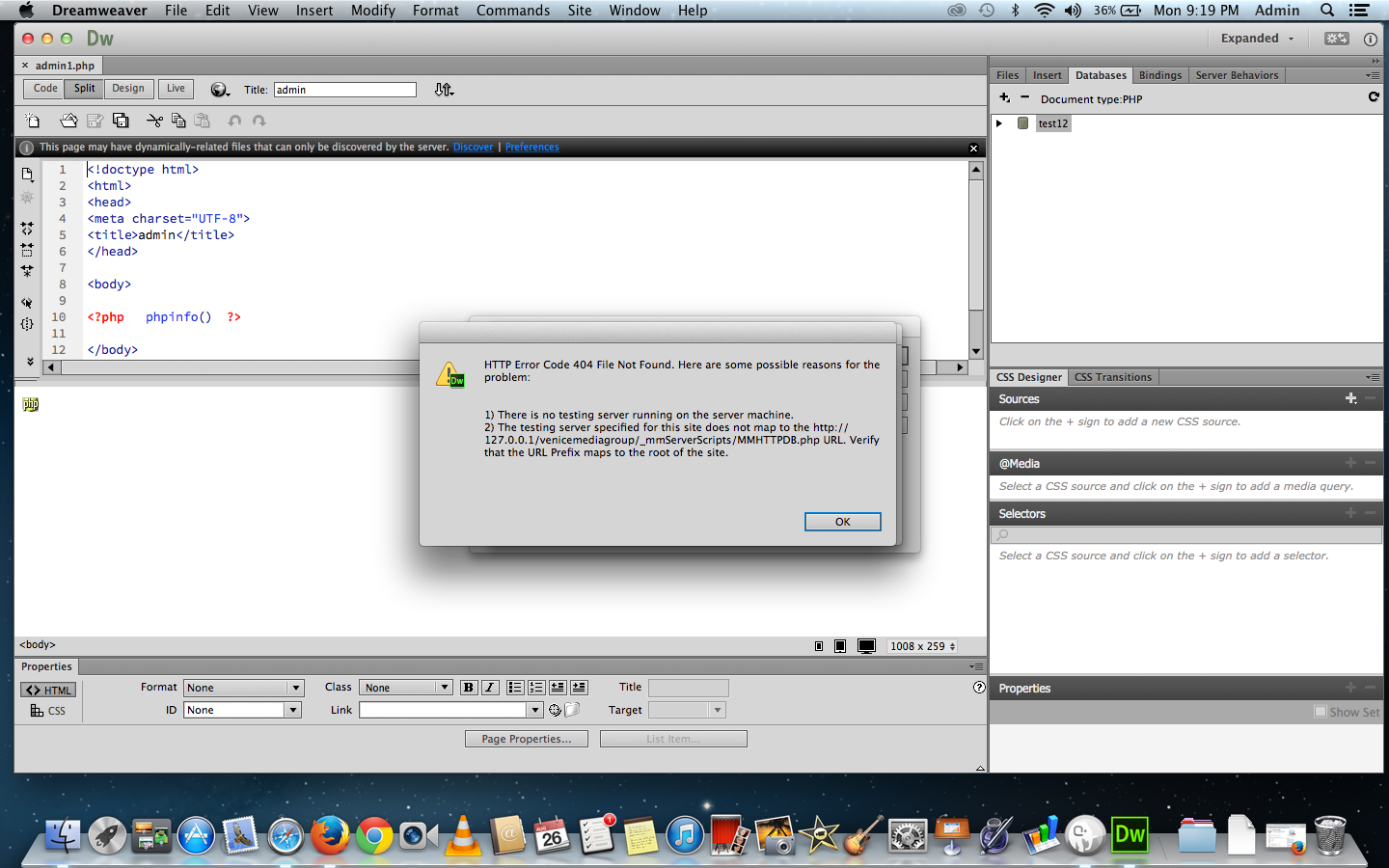

Dreamweaver, can't connect to MYSQL Local Database on Mac
I have never had a problem connecting to database on my PC, but setting it up on a Mac.
 I have  Dreamweaver CC
I have tried every imaginable setting, connection string, etc.
the error tells me there is no testing server on the machine or it doesn't map correctly.
Screenshot attached.

When you go to Site > Manage Sites > Select your site to edit.  On the next pop up, choose Servers.   You may see just one item or multiple.  If you have just one item and you are only using local, then you should have both local  and remote checked.  If you are set up for remote to be on a web server and testing local, then you should have two line items and one checked for remote and the other checked for testing.  Edit the testing server and make sure it maps to your site.
Avatar of edvinson
edvinson
did all of that. I am well versed at that at least on the PC. I am learning there are a couple of connection files that dreamweaver no longer automatically adds, MMHTTPDB.php and mysql.php. looks like adobe is messing with what was a good thing.

I found the answer to this myself but would like to share it with future generations...so-to-speak.
On a Mac, if you are having trouble getting your database to connect in Dreamweaver CC, it's probably not your fault. If you have set up your testing server and the page serves up normally in Live View or the browser, then the issue is probably because Dreamweaver isn't setting a couple of little files for you like it should do.
The file names are: MMHTTPDB.php and mysql.php and they are supposed to go in your folder _mmServerScripts  (only viewable through Finder or an FTP Program) . Dreamweaver automatically hides in in it's file system as it isn't needed on the remote server.
Most likely the folder is there but these files may not be inside.
I found a YouTube tutorial that showed where to find these but I followed the instructions perfectly and also searched my Mac files and they were not to be found anywhere.
So, I went to a PC that I had running CS6, found a random site that I could setup a database on, and did so. Dreamweaver generated the two files, I copied from my PC, placed them inside the needed folder on my Mac and all of a sudden, I am no longer getting the error that said I didn't have a testing server setup on my site.
Initially, Dreamweaver didn't even have "Databases, Server behaviors, and Bindings" available and I had to go into extension manager and install Deprecated Extensions.
I'm thinking....this is really stupid...what good is Dreamweaver if you can't use it for Dynamic sites??? It's like they don't want you to use databases with it?
Go ahead Adobe, mess with it like that and it will go the way of Front Page.
