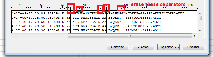

And a capture with the data separators that need to be removed whe importing from the txt
