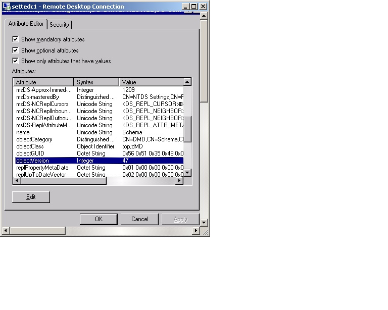

Hi I wanted to verify that i can move all the FSMO roles to one of our 2008 servers and demote this server.  Please see the attached it is our current FSMO server that we are having issues with.
This server has been a dc for a couple years.

Correct-  none of the above steps work.
The problem server (2003 server) contains all the FMSO roles for our domain.
 Figure next step would be to move the roles to a new server?

d2 (non authorative) restore of sysvol worked  - also had a failing Hard Drive.
Thank you
