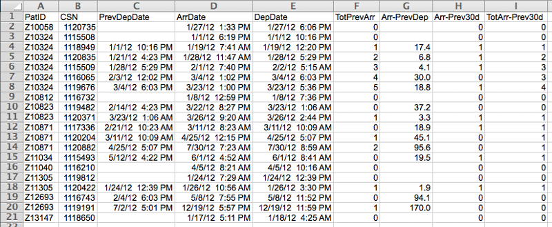

I have a table looking at a group of individuals and their arrivals and departures within a range of time, with the following data points:
[PatID] = ID unique to the individual, repeats indicate multiple visits by the same individual
[CSN] = randomly generated ID unique to current visit; is not ranked by date/time
[PrevDepDate] = departure date/time for previous visit; may or may not correlate with last ArrDate on record
[ArrDate] = arrival date/time for current visit
[DepDate] = departure date/time for current visit
DataI am looking for help with Query design, primarily trying to figure out how to create running totals based on previous records, in order to generate the following outputs:
[TotPrevArr] = a running count of the number of previous visits based on ArrDate
[Arr-PrevDep] = ArrDate - PrevDepDate
[Arr-Prev30d] = 1 if Arr-PrevDep is <31 days; 0 if it is =31 days
[TotArr-Prev30d] = a running count of the total number of Arr-Prev30d that were <31 days to date
OutputIf possible, I would also like to be able to generate a TotArr-Prev30d count for a specified window of time prior to the ArrDate (e.g. TotArr-Prev30d within 12 months prior to ArrDate).
Thank you.

Author Comment
by:manonamtn
Attached is a table with the sample data.
