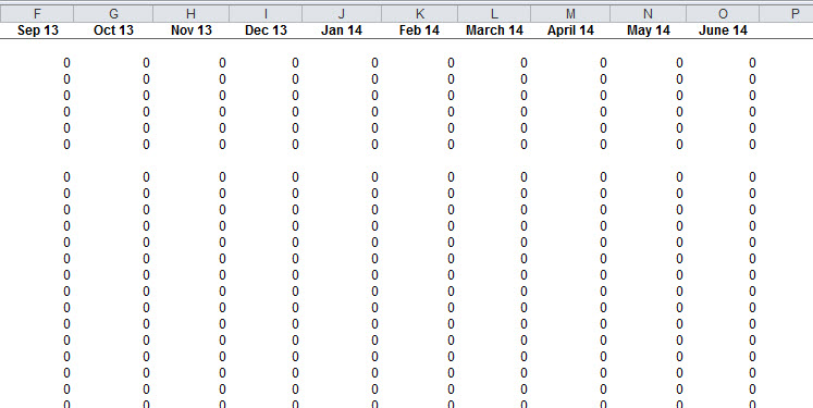

the FY Column remover worked great.
The header column remover did not.
I realized that ONLY the 2nd row under those months is blank. (that's for sales, but they are future months)
However, they (accounting) do put zeroes in the future months for the other categories.
I am assuming that was the issue. I have included a picture to show you what it looks like.
thanks
