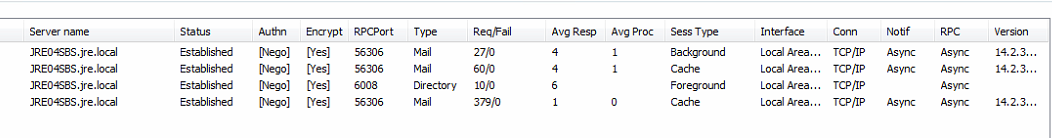

First run outlook.exe /rpcdiag and check if outlook is connecting using http.

Paul-Anthony
Thanks R-R for your feedback
To me it looks like that it's connecting via TCPIP  (see attached)
The setting is already unchecked "On Fast networks, Connect using HTTP first, then connect using TCP/IP”
