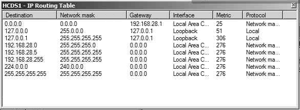

It seems like there is an issue with the traffic to other machines outside of the server. Almost as if the RRAS is not routing traffic to or from those other machines correctly. I attached some screenshots of the RRAS config.
Also does it need a DHCP relay agent if the server is also hosting it's own RRAS?
I also compared it to another SBS 2008 machine that I know is functional and working to see where there were differences. I noticed that the routing table was different (IP addresses notwithstanding). I also noticed that there were a lot more firewall items on the functioning server that start with Network ICMP (all greyed out).
Thanks for any thoughts.
This is the RRAS layout. Note the DHCP Relay item.The NON functioning Server. Another customer's server who has it all working.
