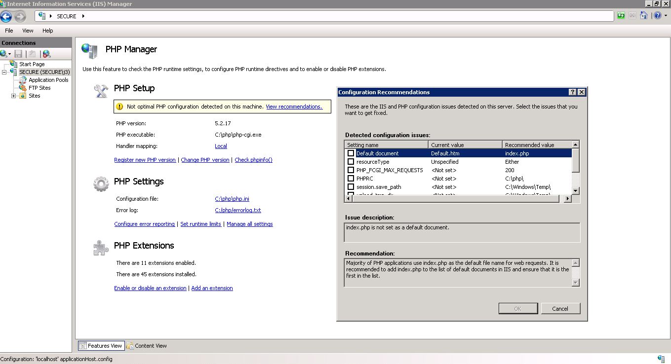

Aaron Tomosky
Aaron Tomosky
If you install php manager (comes with php if you use the web platform installer, you can set the php.ini that IIS watches for changes. Make and change and it automatically recycles for you without interrupting other sites.

there is now icon for php manager.

php manager

C:\php\php.ini
but this is a production server
what is the php.ini file that I have opened (I search and do not see php.ini)
I do not want to break the production server

Aaron Tomosky
By default IIS looks for c:\php\php.ini
This is not usually where your php.ini is
You need to find your php installation folder, probably where I said above, and choose that as the location to watch. This setting will not affect anything except the ability for IIS to watch this file. That's why everything works when this setting is wrong.
rgb192
I investigated for days if I should make change
But then I realized that no change needs to be made because php manager is looking for
c:\php\php.ini
and this is where php.ini is
I can verify by running php script of phpinfo()
I clicked on
configuration-recommendations
