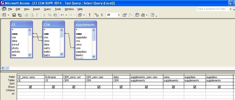

I have an Access 2002 database.
In the database contains 3 tables:  CE, CEM and SUPP
In my query, I want all records from all 3 tables (even if there are no matching record keys) so that then end result would include all records.
See query here:
CE - CEM - SUPP Query
See SQL view here:
SQL-VIEW.txt
See CE-CEM join properties here:
CE-CEM Join Properties
See CEM-SUPP join properties here:
CEM-SUPP Join Properties
The results of my current query only includes records that are equal in the CE Table & CEM Table & SUPP Table.
I would like the query to produce all records from the CE table, all records from the CEM table and all records from the SUPP table.

I think I need a "UNION ALL" somewhere, but I am not familiar with SQL language.
Is there a field that is common to all three tables?
Author Comment
by:LessonsLearned
The CENO field is common in all three tables.

The CE table contains the primary key CENO (indexed with no duplicates)
The CEM table contains a CENO field (indexed, duplicates ok)
The SUPP table contains a CENO field (indexed, duplicates ok)
Note:  I do not have a "join" between the CEM table CENO field, and the SUPP table CENO field.
It looks like the CE table is the master, with a record for each CE.  Is that the case?
LVL 3
Expert Comment
by:0Doc
The UNION ALL  command will basically dovetail the contents of the three tables into the query results without any relationships.  If you have 5 CE records, 4 CEMs and 3 SUPPs, you will end up with 12 records in the end.  It's not useful for most functions.  But, I can help you get started on one if that is what you need.

Yes, that is correct.
All records in the CE table should point to a record in the CEM table using the CENO field.
All records in the SUPP table should point to a record in the CEM table using the CENO field.
There is no referential integrity.
What you can do then is join the CEM and SUPP tables to the CE table using the CENO field and Include everything in the CE table.  That should give you everything.  Give that a try.  However, it may give you some duplicate results. If that is a problem, I can help with that.

The CEM is already joined to the CE table using the CENO field.
I added a join between the Supp table and the CE table using the CENO field.
The results did not change.

Is it possible to do 2 separate queries and merge the results?
For example:
Query 1:  All records in the CEM table and CE table where the CENO are equal.
Query 2:  All records in the SUPP table and CE table where the CENO are equal.
Then merge the results of query 1 and query 2 (sorted by CENO)

Make sure you remove the join between CE and CEM
You could use a union query to merge the two queries.
