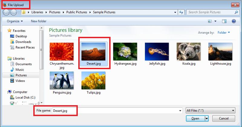

Upload MenuUpload WindowHi,
 I have file upload page (Coldfusion .CFM ) where I can select one file at the time and below is the code. The screenshot above is what pops up when I click [Browse] button from the menu.  Is there a way that I can select multiple files by using <Shift> or <Control> key or <Control>-<A>? When I tried them, none seem to work and I can only pick one file at a time.
No, not with an HTML file control. HTML file inputs do not support multiple file selection. If you need that functionality you must use a signed control, such as flash, applet, etc.
These days, most browsers support flash/applets/etc... but not all of them.  So if browser support is an issue, you may want to stick with standard html controls.
