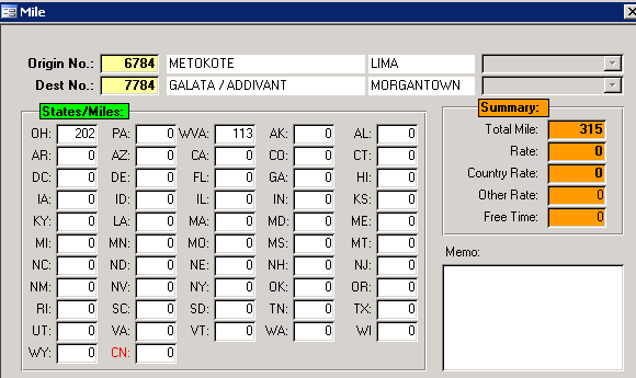

As you can see in the screenshots, The table "Mile" has index file called "ORIGIN_DEST" and when the form is open, it is used in "Order By" field under data tab of the form. So I wonder how it is ok with ACCESS 2003, but it is an error in ACCESS 2010.

The MILE table contains ORIGIN_NO and DESTINATION_NO in numeric value.
So when the user opens the form, I need to display actual cities or place names instead of numbers. So I perform a lookup in both Origin and Destination table. But the funny thing is that I am using FindFirst function that does not require indexes.

When I open MILE table, I see some records with blank ORIGIN_No and DEST_NO. ORIGIN_No and DEST_NO should NOT have blank data because I used them to look up actual city names in ORIGIN and DESTINATION tables to display actual city names in MILE form.
So when all the users are gone tonight, I will remove these blank records and try again.

I removed those blank records shown in ID: 39954423 and there is no more error message.

In attached, I included Table design/ Form Design / related coding.
