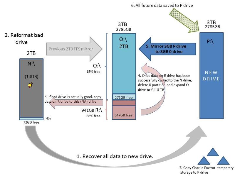

Blah blah blah. So the recovery steps and the new scheme I plan to use are illustrated in the diagram.
1. Using GetDataBack, I have started copying the N drive's files to the new  Seagate  3TB expansion drive.
2. Because of the way N:\ failed, I suspect that there is nothing physically wrong with it. I plan to reformat it and then test the shirt out of it.
3. If I am satisfied it's integrity is good, I will copy the files from R:\ to it.
4. Delete the R:\ partition
5. Expand O:\ to the full 3TB.
5. Set up FFS to mirror P:\ to O:\
6. Save all future data to P:\
7. Copy data from various thumb, flash, stick and pickle drives used to store new data (subsequent to failure) until I had a solution to this debacle with what I had to work with, to P:\.
Harebrained or decent solution?
Excellent solution.  And, the way you describe the failure, I believe GetDataBack should recover everything.  I have the same general setup in use using external USB3 drives and it works great.  My major difference is that I use robocopy rather than  Free File Sync.  I also use Clonezillia once a week on the OS drive and put it on one of the drives that get copied (I have more than one), so that I can be back up and running ASAP. I think you got it covered.
