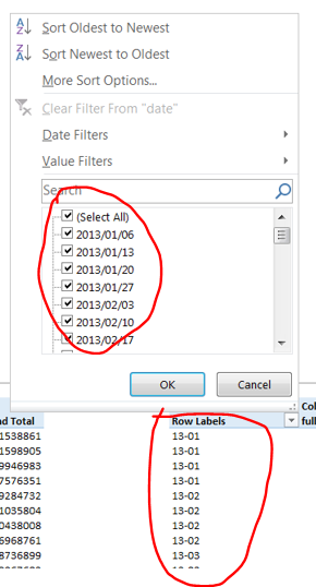

Alas, it's not this easy.  Take a look at this image.
This is from the original file.
The number format button doesn't appear in the dialog.
