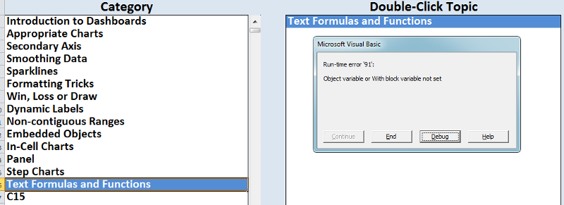

When my workbook is launched it opens with the following error:
DashboardI added in the Name Manager a range at AA from the Topics worksheet and it is labeled TextFormulaFunction. No problem here.
My workbook requires I add the worksheet name to the worksheet "SheetNames" - no problem here.
My workbook requires the name of a Category in the Topics worksheet at AE - no problem here.
Code was need on the Menu tab in the Worksheet_SelectionChange event. No problem here
However, when I select the new Category, in the case Text Formulas and Function I get this:
Objectat this part of the code
run time errorMy ranges from A:Z work fine. It's when I go beyond Z that this problem comes up

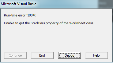

Martin LissOlder than dirtCommented:
Just before the last line in Workbook_Open add
Sheets("Menu").Activate
You should also add Application.ScreenUpdaing lines so that the sub looks like this
Private Sub Workbook_Open()
    Application.ScreenUpdating = False
    GenCategoryFormulas Sheets("Topics").Range("Category").Rows.Count
    Sheets("ScrollbarData").Range("C3").Value = Range("Category").Rows.Count
    ' Select the first category
    Range("A3").Select
    ActiveWindow.Zoom = 90
    '  Make sure that the statusbar is visible
    Application.DisplayStatusBar = True
    Application.StatusBar = "Concept and design by Frank Freese. Programming by MartinLiss at www.experts-exchange.com."
    ActiveSheet.ScrollBars("vscrTopic").Value = 1
    Application.ScreenUpdating = True
End Sub
You don't need line 20 in your code. Even after you make that change you'll run into another problem which I'm working on now.
The problems occurred when you actually clicked Text Formulas and Functions
The first problem was mine and was due to the gstrTopicCol calculation in Menu's Worksheet_SelectionChange event. It worked fine when the Topics column was a single letter, but the new AA column caused a problem. Here's the fix.
In that sub, change
gstrTopicCol = Mid$(Range("D3").Formula, InStr(1, Range("D3").Formula, "!") + 1, 1)
to
    Dim intStartPos As Integer
    Dim intEndPos As Integer
    intStartPos = InStr(1, Range("D3").Formula, "!") + 1
    intEndPos = InStr(intStartPos, Range("D3").Formula, ",") - 1
    gstrTopicCol = Mid$(Range("D3").Formula, intStartPos, intEndPos - intStartPos)
To be consistent the two new Dim statements should be moved to the top of the sub with the rest of them.
The other problem is yours.
In Name Manager you had TextFormulaFunction as the name of your new range while in code you referred in at least one of the two places that name is referred to you had TextFormulaFunctions. I changed the Named Range name to TextFormulaFunctions and made sure that both places in the code matched.
