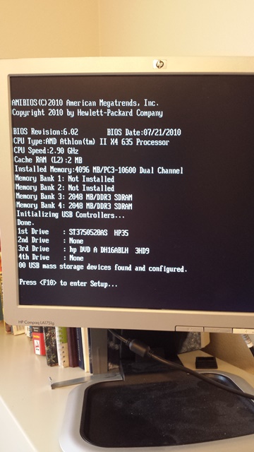

From shutdown, when I try to boot this windows 7 64-bit machine, eventually the Reboot and select proper boot device or insert boot media...... message appears. First there is attachment 1, then attachment 2. After hitting ctl-alt-del, then tapping F10 to get to bios (ver 6.02, attachment 3) , I arrow over to Boot, down to 1st Boot Device, enter,select HDD group, enter. Then F10 to save and it boots. Now, restart will always reboot, but not ever after shutdown.
Things I've tried: Replaced CMOS battery, Restored to original configuration, bootrec.exe (fixmbr and fixboot), repair startup, etc. Any assistance will be greatly appreciated. It appears that it's trying to go to a network boot 1st but not sure why.

It does not find a boot drive to boot from. Means:
1) either the HDD or RAID is not detected
2)There is no boot files on the drive installed
Is this RAID based system?
When you boot from Windows 7 Installation media to repair mode and get to command line go to Diskpart and see which partition is set active. And how many partitions are there on the drive.

SaschaoCommented:
memory dimms only on bank 3 and 4? You should start with bank 1. The second RAM should be on bank 2 or 3, depends on the system.
In BIOS -> memory you should see either single or dual mode - try bank 2 or 3 - if it is on dual mode take this setting.

Update: 10/2/2014 1PM Eastern.
Using SeaTools from Seagate, I ran their tests on the hard drive which all seemed to pass.
Then, taking Sascha's advice, I swapped the memory modules; first to slots 1 and 2, then to 1 and 3. Still, the system, upon restart from shutdown, appears to want to boot from the network. I ran Paragon’s fix recovery, ran all options that recognized the Windows 7 OS, again, to no avail. I even bought another new CMOS CR2032 battery, still nothing.
The strangest thing is this: After getting the initial message below (which started this thread), I'm able to hit Ctl-Alt-Del to restart, then F10 to get to bios, then F10 again to Save WITHOUT MAKING A Change, and the system reboots fine. It also reboots when doing just a restart; it comes back normally after Sleep.
Unless I've missed something, I'm going to call it done. Thank you all for your input. I'm stumped.

Danny ChildIT ManagerCommented:
I think you had a failing disk that wasn't spinning up properly or passing its own internal diagnostics from a cold boot, but would sometimes get going from a warm boot.
If the disk wasn't reporting itself as a viable boot device in time, the BIOS would step past it to the next available option, in your case, attempting to boot from the network.
But, glad it's working now.

noxchoGlobal Support CoordinatorCommented:
Warming up HDD? I know the trick how to get the drive work by freezing it but the theory about disk which needs to warm itself up sound crazy. I don't think that Paul is working in open air at south pole so that difference in few grades could affect the boot from this disk.
The problem lays here in the disk's health or Windows installation itself. The test with new installation allowed us to exclude BIOS from the list of suspects. And the error given by HDD check leaned the suspects to HDD.
