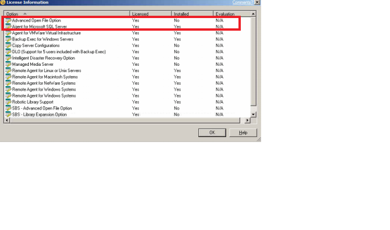

BackupExec - Restore Backup Job History and SQL Data Folder BackuExec Version BackupExec License Information
  I have Backupexec running on Windows 2008 Domain Controller (named "DC1") and a Windows 2003 Server running Microsoft SQL database. I did not install Backup Exec software, but I thought all SQL database files were being backed up. The other day I discovered that I could not restore SQL database file "TMW_LIVE.mdf (17GB)". So I checked backup Job History from one random day and learned that these SQL database files were "skipped" because they are OPEN.
 How do I need to do to close these SQL database files during the backup time and reopen them after the backup job is run?

You can backup your SQL Databases online easily because you have the SQL agent licence in backup exec. That is its purpose and if you have the licence you had probably paid for it. Sure you can also backup your DB with a dump, it is free, but it is less comfortable.
To use your SQL agent, when backuping your server with backup exec you must browse to select different objects than classic folder/files. When selecting which data to backup on your server in Backup exec, you should have an object named SQL server under your server, at the same level than the server's local drives. If you use this object to backup in your selection it will use the SQL agent.
If licence and agent for SQL are finally installed in Backup Exec there is nothing more to do.
