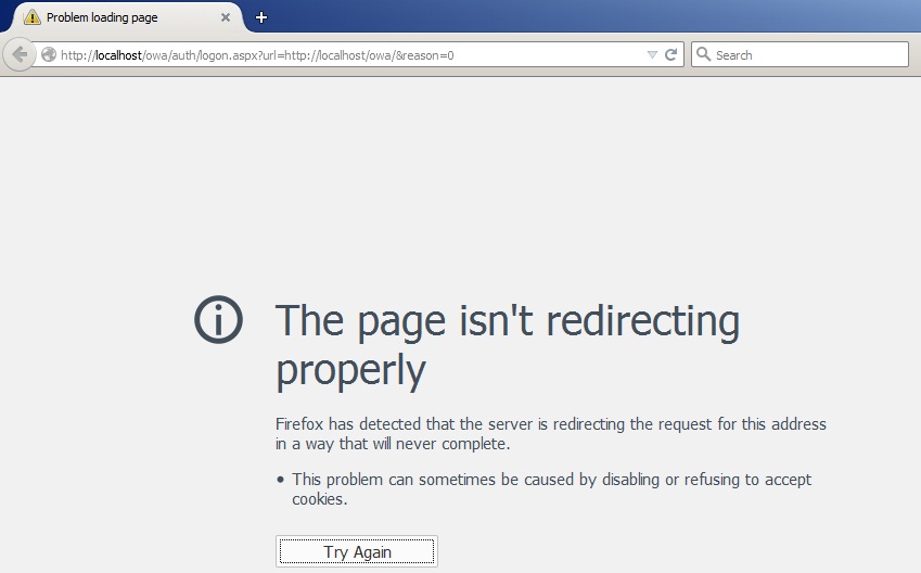

That's not the issue.. Its redirecting fine, just not linked or connecting to the server.. Let me know if you can continue to help me..
Avatar of Joeteck
Joeteck
Here is the error message when I try to open it up... happens via Firefox or IE

Any load balancer? Or TMG? or ISA?
Avatar of Joeteck
Joeteck
Negative.. just to servers..
Avatar of Amit
Amit
Flag of India image
When you restarted these server. That's the first step, I will do before doing anything else. Sometime Non paged pool memory issue causes IIS to stop working. So restart it. Next you can use wireshark to check what is going on. Finally, we can call MS.
