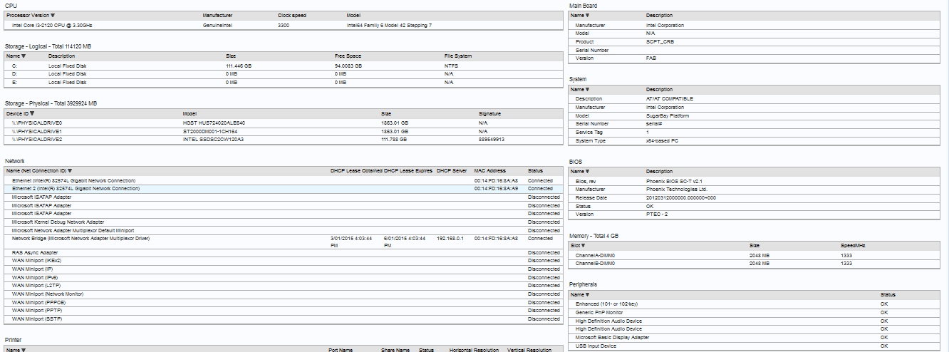

Avatar of Olaf De Ceuster
Thecus still hasn't got back to me....why does that not surprise me. They are really slow.
Posting the device manager and driverguide findings. Hoping you might see something that could help User generated imageme?
Olaf

MB Details:
User generated imageOlaf
