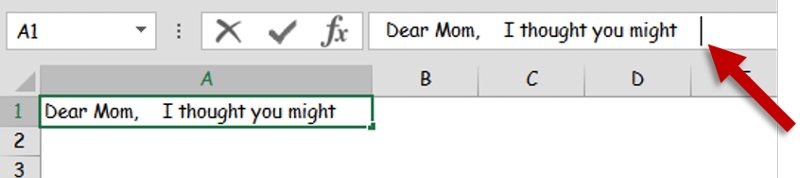

Clicking the formula bar and pressing Ctrl+{End} reveals the presence of invisible characters (presumably spaces) at the end of the entry (arrow points to the cursor):
Fig. 1

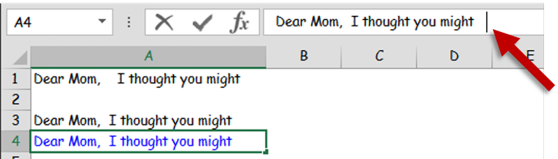

However, using the TRIM() function in cell A3;
Fig. 2
then copying the result and using PasteValue in A4, shows that — due to their persistent presence — the invisible characters are not simple spaces;
Fig. 3

The contents of the cell includes two carriage return (ASCII 13) characters.
Dear Mom,
  I thought you might
There is a space character after the last word, "might".  The Trim() function will remove this character.
