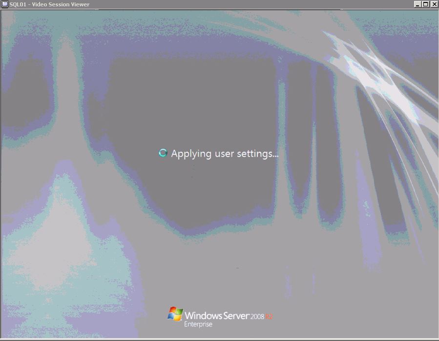

Until last Friday. They had another power drop. I was called to site. Same deal. Log on screen shows fine. Domain Admin details entered fine. Then nothing. Looks like its loading. All the same symptoms as above.
Arrived this morning and this is showing:
User generated imageAnd again that server is showing:
Any ideas?

I have entered the log in credentials and its sitting on this screen:
Been like that for about an hour. Still cant browse admin shares so I dont think it worked?
