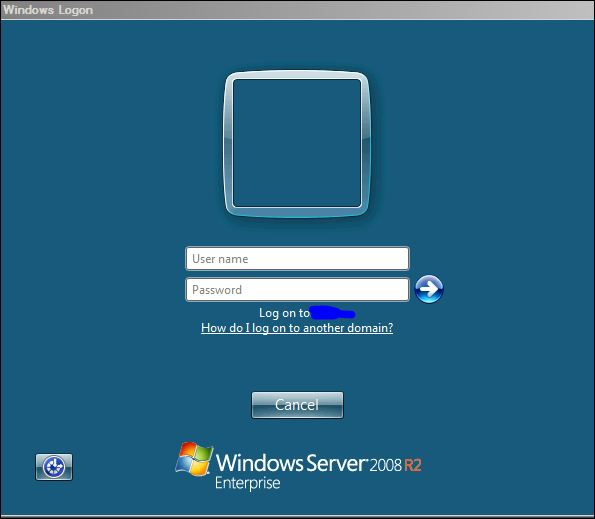

Hi All,
I have two web interface with pass through method. From one server when I launch Citrix it asks for server password while from other web interface it launches fine. This is happening for all application. The issue seem to be with some settings on web interface. Can anyone help me?

Harinderpal Singh
I am referring to pop up which is in attached file.

Are you saying this is specific to one WI server or one XenApp server?
Harinderpal Singh
It is to web interface server. As I stated above, I have two web interface servers. From one I get pop up when I launch the application but from another it launches without it.

Are you sure it is a WI issue? When you get the popup for authentication, login, go to a cmd prompt and see which XA server is used.  Is it always one or is it both?
Harinderpal Singh
I found one more thing. If I use explicit authentication for that server then it work fine. The issue is when I use pass through.

It worked re installing Citrix by including SSO on client machine and by editing policy.

Yes it was not web interface. I will have to push the policy to all Client machines.
