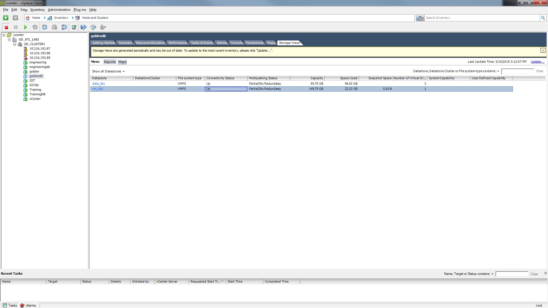

Im trying to start a VM and Im getting the following error (error_1 attached).
I dont undertand where exactly s the problem since I still have 800MB free in the datastore assigned to this VM... which are the data_ds1 and the vm_ds1.
I believe the issue is somehow at the vm_ds1. (but it has 4G free - see disk_2 attached)
The sum of space used among the VMs that shares this datastore doesnt reach its maximum capacity...  (prints attached)
The VM swap location has to be in the same directory of the VM since it is in a cluster.
Anything I might be missing/misunderstanding?

Every time you power on a VM, a SWAP file is created equal to the size of memory, or the reservation if any set in the VM.
If you do not have the space available on the datastore, the VM will fail to start!
This VM needs 4GB, so you must have 4GB available on the datastore.
Your datastores are terrible low, you must allow at least 20-25% FREE on the datastore, to allow for SWAP files and Snapshots if applicable, otherwise VMs will fail.
Options:-
1. Relocate the VSWAP file to another datastore with space.
2. Move the VMs to another datastore with space.
3. Increase the size of datastores.
see here
http://kb.vmware.com/selfservice/microsites/search.do?language=en_US&cmd=displayKC&externalId=1030719
http://kb.vmware.com/selfservice/microsites/search.do?language=en_US&cmd=displayKC&externalId=2030250

I moved it and its working but still I have like you said very low datastore. I may have to delete some VMs in order to have the 20-25% you mentioned its ideal.
By now I have this: (attached summary report)
