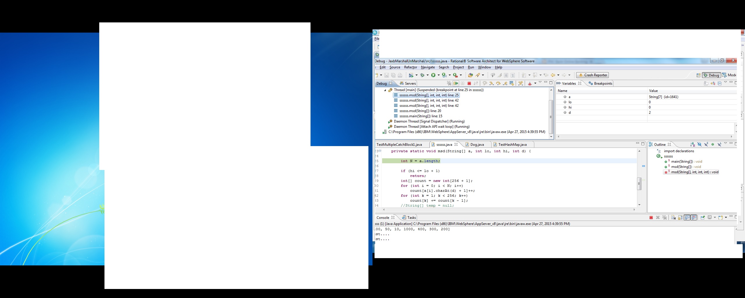

gudii9
import java.util.Arrays;
public class ssssss {
	 * @param args
	public static void main(String[] args) {
		// TODO Auto-generated method stub
		String mystr[] = { "100", "50", "10", "1000", "400", "300", "200" };
		System.out.println(Arrays.toString(mystr));
		msd(mystr);
	public static void msd(String[] a) {
		msd(a, 0, a.length, 0);
	private static void msd(String[] a, int lo, int hi, int d) {
		int N = a.length;
		if (hi <= lo + 1)
			return;
		int[] count = new int[256 + 1];
		for (int i = 0; i < N; i++)
			count[a[i].charAt(d) + 1]++;
		for (int k = 1; k < 256; k++)
			count[k] += count[k - 1];
		//String[] temp = null;
		String[] temp = new String[a.length];
			temp[count[a[i].charAt(d)]++] = a[i];
			a[i] = temp[i];
		System.out.println("test....");
		for (int i = 0; i < 255; i++)
			msd(a, lo + count[i], lo + count[i + 1], d + 1);
i tried as above now getting error as below
[100, 50, 10, 1000, 400, 300, 200]
test....
test....
Exception in thread "main" java.lang.StringIndexOutOfBoundsException
      at java.lang.String.charAt(String.java:465)
      at ssssss.msd(ssssss.java:31)
      at ssssss.msd(ssssss.java:42)
      at ssssss.msd(ssssss.java:20)
      at ssssss.main(ssssss.java:15)
please advise.  I wonder why the temp needs to be initialized with lenght.

gudii9
	 * @param args
		msd(mystr);
		int N = a.length;
		if (hi <= lo + 1)
			return;
			a[i] = temp[i];
not sure how to fix above code. please advise
