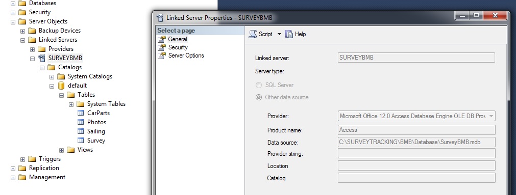

gowflow
I don't know maybe this could help you this is the structure that I have in SQL Server for this database just the name has been changed to KSGBMB
link server
gowflow

First make sure that you have linked Access database correctly. In sql server management studio, navigate to the linked server, and verify that you can expand its object down to the table you want, and you don't receive any errors.
screenshotOn this screenshot, DB is the name of the linked server and Table1 is a table in Access database.
Once this is done, right-click the table in the linked server, and generate INSERT script, then modify it for your application. It probably will be INSERT INTO SurveyBMB...Survey

The problem lies in VB6 to communicate with the link server. I have the same screenshot that you have and my access database was linked successfully. My problem is that I need to run the INSERT INTO from within VB6 and not on the Querry screen this is software that need to update data constantly.

Tks for taking the time. let me clarify again:
I was using successfully
insert into survey in "c:\surveybmb.mdb" select * from survey "c:\server2014.mdb"
UP UNTIL the moment we have this new software that requires that the link database that is between htem and us namely surveybmb.mdb be in SQL Server as their software can only receive and send data thru SQL Server this is where all this came up !!!
So I know that if the file is form the outside not envolving SQL Server and thru Access I have no problem and been doing this for the past 30 years PLUS !
Now I have SQL Server to which I am a total newbie and I need to know the connection that can deal with SQL Server and Access at the same time link I originally posted
INSERT INTO SurveyBMB.Survey
 SELECT * FROM `Survey` IN "C:\SURVEYTRACKING\Survey2014.mdb"
 WHERE Survey.VESSEL = 'ABC 24/14' and Survey.[Date Arrival] = '11/7/2014'
 ORDER BY Item
Where:
SurveyBMB.Survey is a linked server in SQL Server
Survey2014.mdb is an Access database outside SQL Server.

William Peck
Vadim Rapp
The sql statement you posted can't work because one part of it can run only on sql server (from SurveyBMB.Survey , SurveyBMB being linked server in sql server); while another part can run only in Access ( IN "C:\SURVEYTRACKING\Survey2014.mdb" ). Access does not know about linked server; sql server does not know syntax "IN <external database>", and in any case, one sql statement can't run in two different database engines at the same time.
You have to decide, whether your vb6 program will connect to sql server and run
insert into linkedserver1...table (...) select * from linkedserver2...table
or connect to Access and run
insert into table in "mdb1" select * from table in "mdb2"
(which is what you have been doing)
, or you can code in vb6 extraction into one recordset connected to Access, followed by insertion into another recordset connected to sql server; or it can be even one recordset changing its connection. But it can't be one sql statement.

gowflow
Maybe I don't see the full picture, but I don't understand why you need to change anything at all. That fact that now surveybmb.mdb is also accessed by their application through sql server does not mean that you can't do anymore what you have been doing all the time, i.e "I was using successfully insert into survey in "c:\surveybmb.mdb" select * from survey "c:\server2014.mdb"
Verry correct I am still doing this and the file is connected thru linked server so they can see it
HOWEVER
I am taking precautions as do not know how they will connect this file to SQL Server they mentioned something like thru Integration Services (totally ignore what it is) I am afraid that we will be brought to maybe need to communicate with SQL Server and not to Access as a linked Server this is why I am going with all this altogether.
Now this being said you mentioned 2 recordsets which is maybe a solution
Can you please provide the code and syntax from Connection to SQL to creation of recordset for
ORDER BY Item
This way I would try it and if it is workable time whys and results then we would have maybe an alternate solution ?
Thank you for your detailed info as this is helping me greatly.

Vadim Rapp
No, you can't. Recordset is programmatic object in the client application. Client application sends to sql server Transact-SQL commands, that's the only thing SQL server understands.
> to achieve a 1 time execution with Execute ??
Unless you are working with millions of records, it's not something to worry about. The time it took for you to type your last comment most likely exceeded any time savings from such a solution you would achieve in 1,000 years of daily execution.
